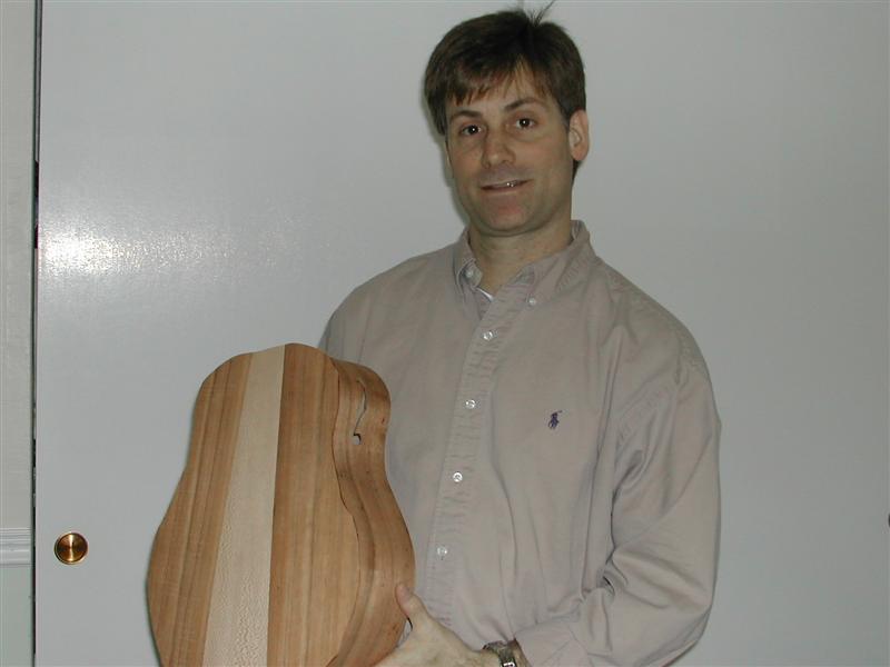

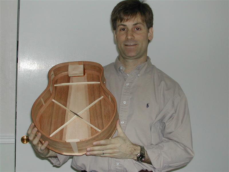

This weekend was productive! I got the back glued on. Next is the top! Enjoy.
PostPosted: Mon Mar 13, 2006 8:37 am
Posts: 688
Thanks Hesh! This is a Koa/Sycamore/Koa back. The top will be Cedar. It will be a 8 string Pin bridge Bouzouki.

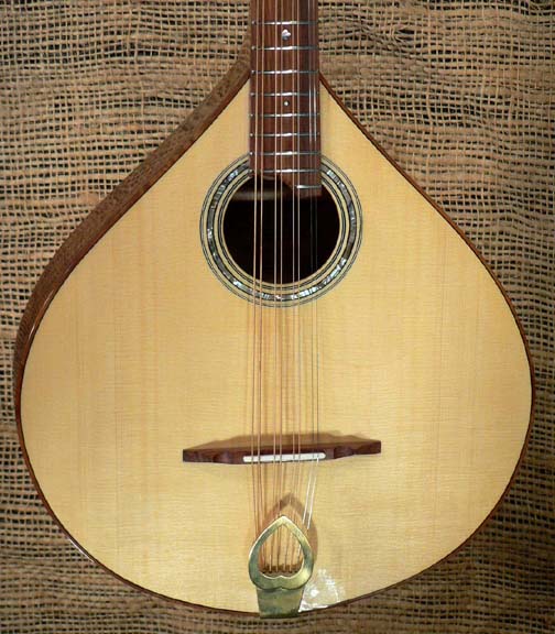

Hey Mark, can we get a full shot of that? Thanks...
PostPosted: Tue Mar 14, 2006 9:03 am
Posts: 575
Believe it or not, I can't seem to find a photo of that one- it has a heart-shaped soundhole. But here is one with a round hole, just like it.

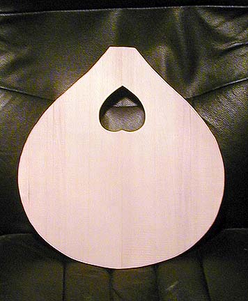

PostPosted: Tue Mar 14, 2006 9:05 am
Posts: 575
Here's a photo of the one with a heart-shaped hole, before it was finished. It's the only one I have done with this soundhole, and I like it- I should do more this way. It has a feminine look to it! <G>

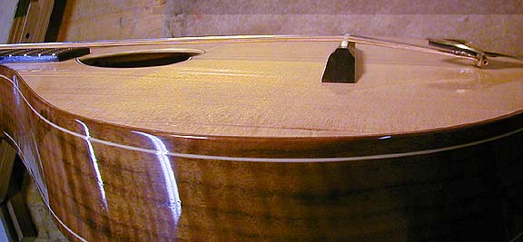

Here's a couple of pics of the one I mde for myself based largely around Stefan's original design. This one is 25.75" scale length and has a 16" lower bout width:
